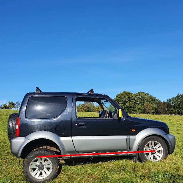

22 Feb 2021 21:36 - 22 Feb 2021 21:59 #233116
by Busta
Replied by Busta on topic Re:OME on Jimny, what's the point?
There's a "show us your flex" thread somewhere on this forum. I have noticed is that the amount of extra articualtion gained from most 2" lift kits is minimal. There are exceptions, but generally speaking if you draw a line from the centre of the hub of the "compressed" wheel parallell with the sills of the car, it will line up with the top of the rim of the uncompressed wheel. Here's mine. Very similar results to those posted above.
