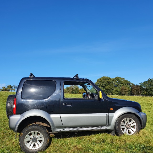

by 300bhpton
This is probably the closest picture I have to yours with the 4th Gen.
Flex is ok, but it does pick wheels up off the ground a bit too often IMO.
You can see here the rear wheel isn't really touching.
Replied by 300bhpton on topic OME on Jimny, what's the point?
Lambert wrote: Dreadnaught seems to flex quite well for standard height suspension

As that picture was taken there was still enough ground pressure to clear the obstacle in 2wd low so there was probably a bit more flex to be found though probably not much. If we ever get to go back to car shows it might be interesting to get up an articulation ramp and find the proper index numbers for various options.
