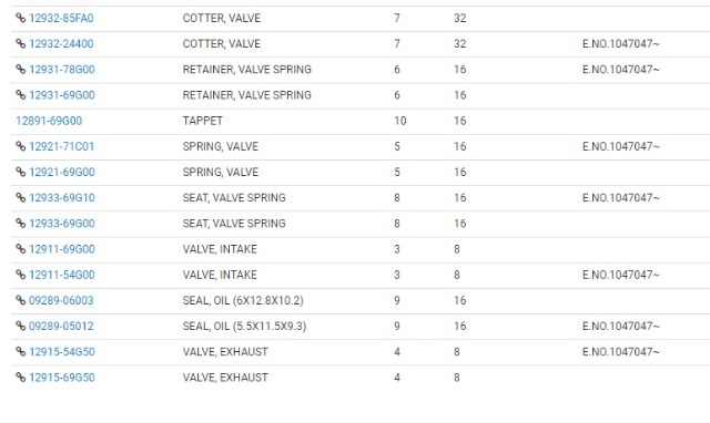

Thanks for the quick reply! When you say the parts from the old head are not interchangeable (which I have discovered through some quick test fitting) would it be possible to get some part numbers for the cylinder head with the valves marked '69G'? Those part numbers bejng:
- Valve cotter(s)
- Valve spring locators
- Valve spring retainers
- Valve stem seals
Or are all of the part numbers listed in the screenshot the part numbers for the valves marked '69G'? Only asking as I see 2 P/N for valve stem seals?

20 Sep 2020 14:50 #228370
Replied by mlines on topic Cylinder head swap, new cylinder has different valves?
Doesnt that screenshot have all the information you need?
Where the part is common, it appears once. where it is different depending on Engine number it appears twice
