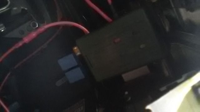

Perhaps its the heat but I cannot find the cabin fuse box !!!!! All the manual says is that's to the right of the steering wheel,under the dash. The pictures show a protruding box like thing,,,but not on mine it isn't. Any ideas please ?

It's should be right of the steering wheel, under the dash (UK model). BUT you need to stick your head in the foot well and look more towards the dash side, a causal look will miss it, it's tucked high. It's a green plastic box about 4 X3 inch.

Here is a bad picture of mine, very difficult to even photography. It's near the bonnet release.
Mine has extra red cable entering for accessories.
