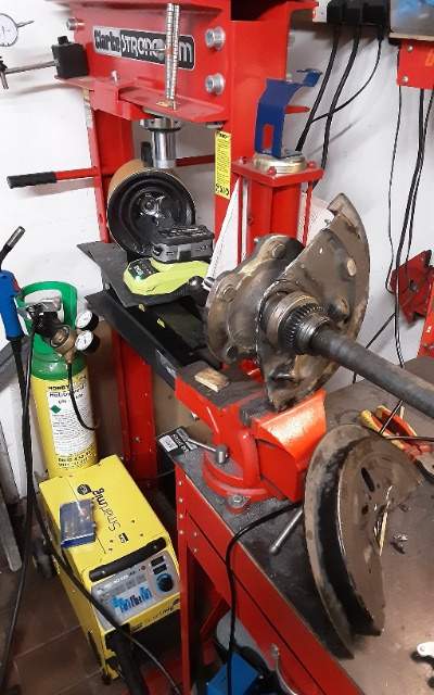

Yeah, I was planning to brace the housing...I have a GYS SmartMig 162 machine which works on single phase socket but I had to realise that my fuse in the garage is not up to this kind of task :dry: As an absolute beginner in DIY welding I was practising to get the right settings but once I turned up the settings which theoretically suitable for 3mm+ steel it had cut off the fuse.
And in the current situation I cannot even take it anywhere to get the job done.
so likely I will need to take it apart again, once I could learn how weld this thick stuff. I guess saving anything from my backplate is not possible...:whistle:

Replied by HUN on topic Complete rear axle removal
Thanks for the advice. I should have asked about these things before I butchered everything! :laugh:
