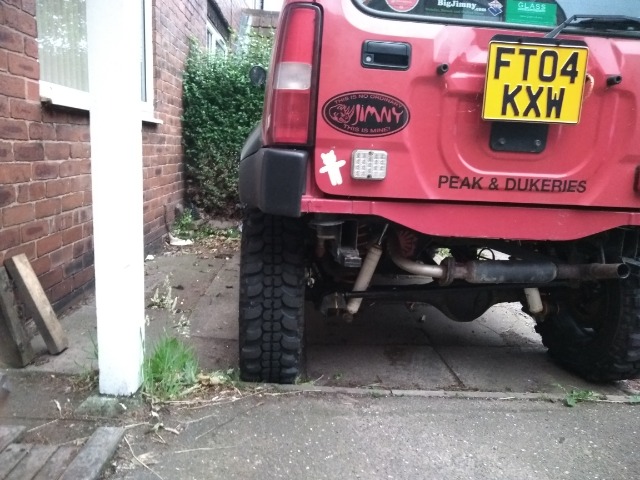

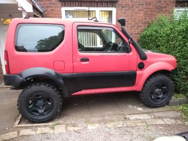

I have +3" arms on a 2" suspension lift radius arms are not cheap
BUT has to be in the top 3 on my mod list car drives very well
My tyres are 195/80/16 extreme
(So i would say get the arms
go 195/80/15 the most aggressive remould/retread you like
2" black raptor suspension)
Just paint your standard wheels black
You would need gearing changes to run my size tyres and also 1" body lift
