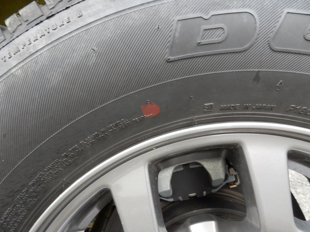

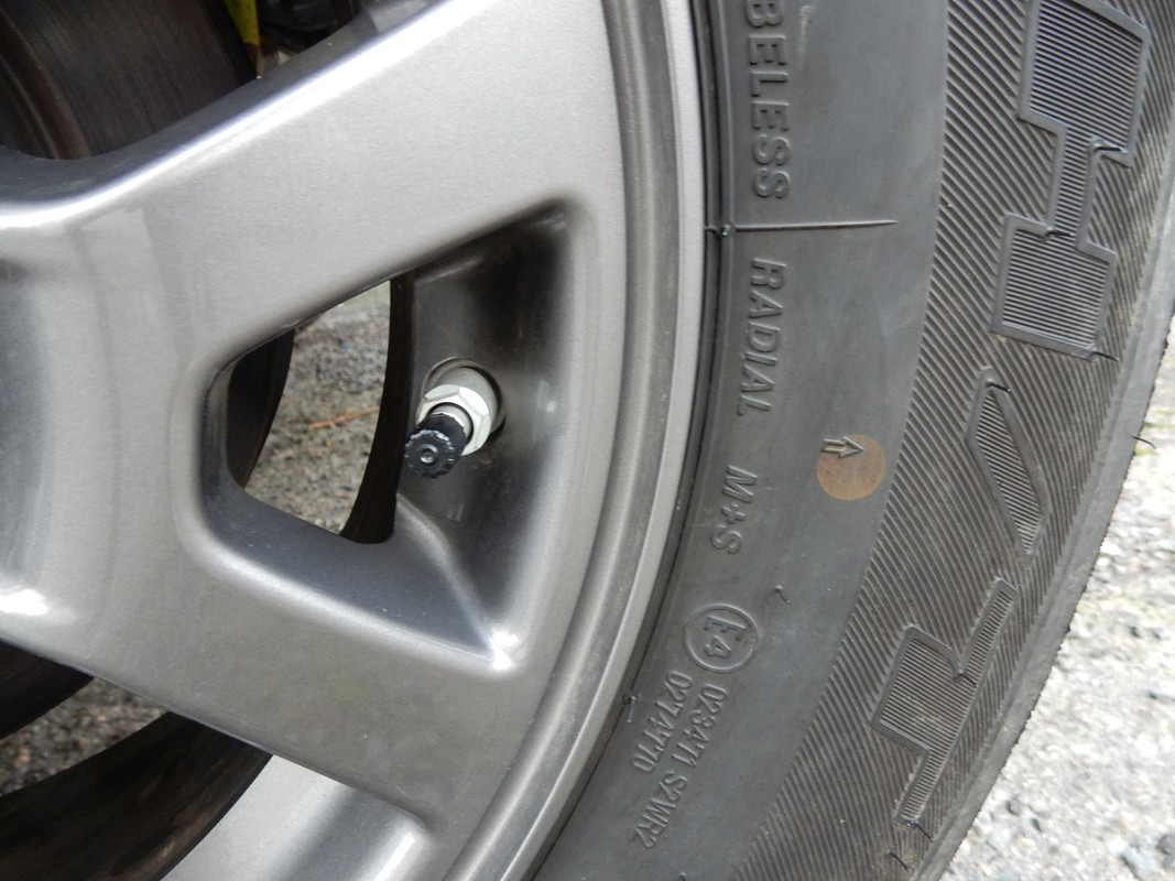

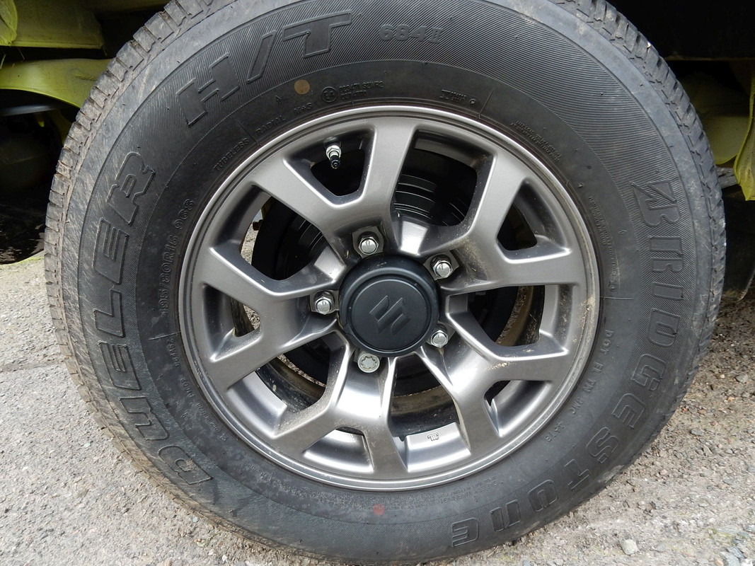

07 Sep 2019 07:07 #213243 by stiffsteve204me
Lambert wrote: Another thing that is probably of little use now the tyres are fitted is that all new tyres will have a small yellow dot somewhere on the sidewall. This is a marker of the lightest part of the tyre and allows the tyre to be fitted with this mark against the valve on the rim, offsetting the weight and making the assembly easier to balance. It's why brand new cars have hardly any balance weights from the factory. It seems that most tyre fitters either don't know or don't care about this even if it would actually save them time and money.
I did not know that, Lambert - so I had to go out to the Jimny, and have a look.:laugh:
OSR
[img
OSF
[img
There is, also, a red dot.
[img
[img
The yellow dot, is, as you say, along side the valve on each wheel.
Steve.
07 Sep 2019 07:26 #213244 by facade
The red dot is the point of "greatest harmonic force" = the highest point of the tyre when it is rotating.
Steel wheels are rolled and welded together, and they won't be perfectly round, so the lowest point is marked with a punch mark, or a coloured dot on the rim. My gen 3 had blue dots on the rims.
If the rims are marked, the red dot is lined up to the rim marker, ignoring the yellow, as this makes the wheels have less radial run-out, and gives a better rotating balance.
If they aren't, the yellow dot goes by the valve, which helps with static balance.
I assume that as the wheels are cast, and have to be machined round, that it isn't much trouble to make them properly round to the locating holes in the first place, so they don't have any measurable radial run-out, so they aren't marked. (Rather than the less charitable explanation thatSuzuki couldn't be bothered testing and marking them :laugh: )
The following user(s) said Thank You: Lambert, stiffsteve204me
