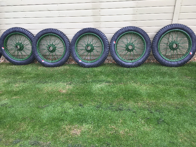

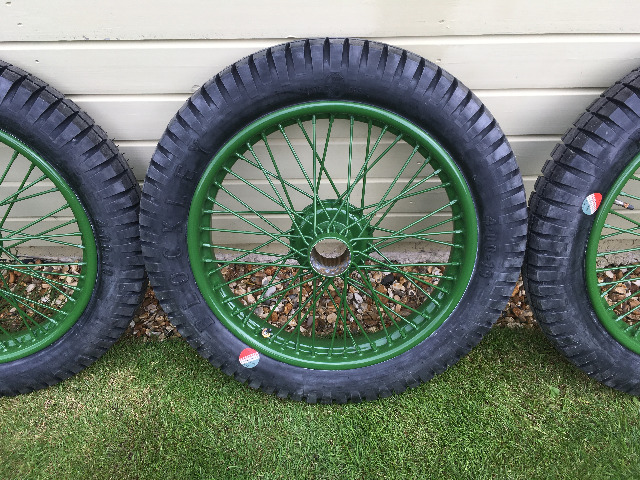

17 Sep 2019 06:47 - 17 Sep 2019 06:48 #213594 by Max Headroom
Thank you for your comprehensive reply!
Well... I went ahead and bought some from Dynabeads UK - not for the pre-war car but the Jimny (the pre-war motor is way off being driven yet)
The 4x4 beads are bigger and, as you say, won't go down the valve stem so I've elected to use the smaller beads, the only difference being... they're smaller - probably easier to lose when the tyre gets changed though.
All the reviews I've read anywhere, are really very good.
I will get round to putting them in the vintage tyres once I've convinced myself :ohmy: :whistle:
