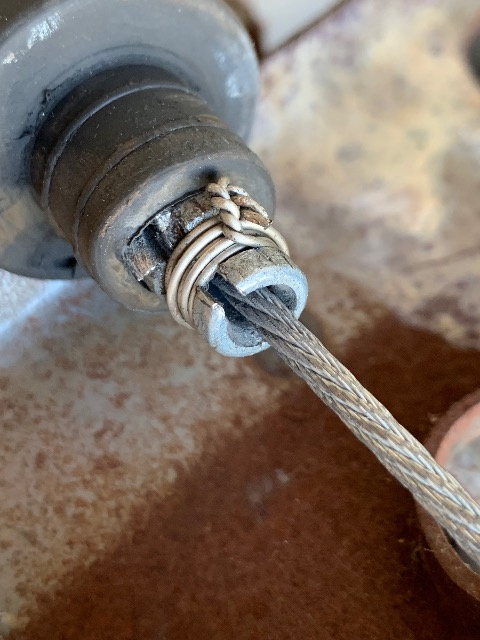

It's good, work done, welded by a mechanic who did the same work on another Jimmy a few months ago. I also found this topic on bigJimny, same problem so it's not that rare. html
link
Disassembling the pedals is quite easy. As you can see, the wire has slowly cut the end of the sheath due to the misalignment, I am waiting for a new cable but this one will do the job for a few weeks
thank for your help !
