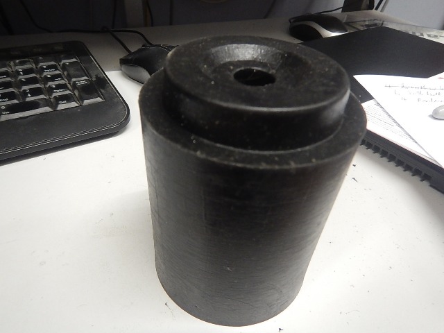

Hi Mates,
I received my body lift spacer kit and discovered that the diameter of the spacers is 2" instead of 2.5" which is the same size of the rubber pads.
Is this diameter ok for surface coverage area? I would have preferred it to be the same diameter as the rubber pads.
Also the center holes in this kit is fairly bigger than the bolt passing though them, concerned about that as will with the extra space. The material is made of some sort of plastic, I just called up a local material supplier and they have 2.5" diameter nylon in stock, I am tempted to go but a foot of it and machine my own spacers.
Not hard to do, I can cut the spacers on my band saw and then make then perfectly flat and drill the right center hole size on my lathe...what do you guys think? See attached pic for what I shipped in.
Thanks.

Personally I would prefer the spacers made of aluminium rather than a plastic. Not much more difficult to machine if you have a lathe and a band saw.

My 2c, I'm bitter I know...
I used to make mine like this -
(Photographed upside down-that moulding sat in the body mount cup on the chassis)
These replaced the original body mount but were 2" higher, made from moulded Polyurethane - the stuff they make poly bushes out of.
Same principle though, but instead of - as you say - a 2" diameter spacer sat on a 3" original body mount pad.
BUT, that was back in the good days, these sort of budget body lifts have ruined my trade and no-one (except the discerning few) would now purchase a body lift kit for what would be about twice the price :(
Dave (Bits4Vits) :evil:

Lambert wrote: Personally I would prefer the spacers made of aluminium rather than a plastic. Not much more difficult to machine if you have a lathe and a band saw.
The trouble with aluminium spacers with a steel tube / sleeve bolt going through the middle... is that they "cold weld" to each other, some chemical reaction that makes them impossible to undo...
Hence why they changed from aluminium to these hard nylon blocks...

Looks like a "4x4 Outlet" one? (Cough... JimnyBits!)

Those washers should be thicker and a larger diameter, like this -
Aluminium block added for comparison too...
Rant over ;)
Yes, you're right... you get what you pay for ;)
