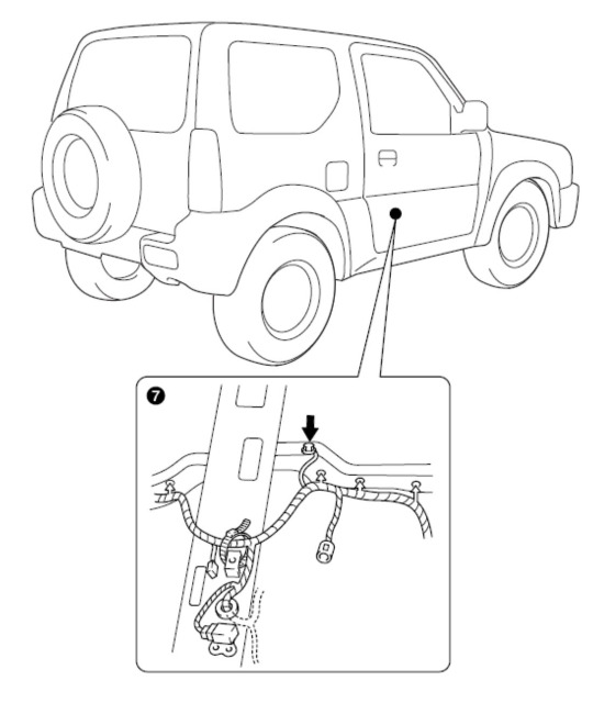

The two yellow candles at the front seem yellower than usual, but the live voltages check out, and the manwal reckons I want earth point 7.
Where is it?
The obvious one under the dash near the switch is 6, the one on the crash detector is 8
here is the location diagram
Is that inside the door or what?
Where is it?

29 Sep 2018 11:25 #196357
by facade
Replied by facade on topic Where is Earth point 7 ???
Thanks!
But on mine, there appears to be a one piece carpet over it, and then someone has gone and screwed a seat down on top of that for good measure :pinch:
I'll just stick to roads with streetlights I think
