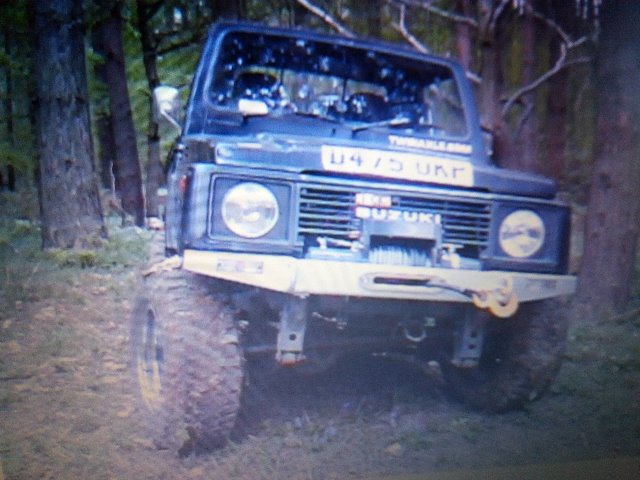

03 Apr 2018 19:47 #191257
by Jezz
It's been fettled just a tad.
Replied by Jezz on topic Jimny from Japan! Tire specifics question
