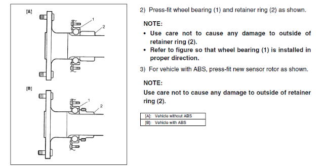

I have more or less the same problem and symptoms. From the strip down its wheel bearings for me (and the full axle is off for a cleanup and some strengthening plates here and there).
This is from the manual:
and this is what it was like once taken apart...
