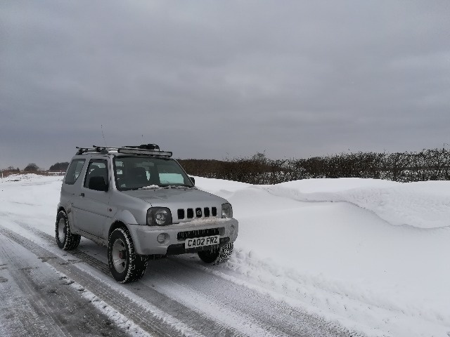

Hi all
I recently picked up my first Jimny, actually my first off roader. It has come on what I'm told are vitara fatboy alloys, these have 255/65 15 Cooper cobra radial G/T tyres, I have only driven this one and one that had a 4"lift so can't really compare how it drives to one with standard wheels but it tramlines... Alot! The tyres have seen better days so i will be wanting to replace them shortly, the question is, what with? I intend on trying out some greenlaning but will be taking the Jimny on the road a lot too. Are the 255's too big and will the alloys which are around 8" wide be able to take a more normal sized tyre?
Thanks in advance.

22 Mar 2018 08:33 #190724 by Busta
Replied by Busta on topic 255/65 r15s any good?
There is no need for tyres that wide on a Jimny, the choice of good off-road tyres is limited and you will find it is much better on and off-road on narrower tyres. You wouldn't want to fit anything much narrower on those rims though. I'd try to pick up a set of standard rims with some good AT or MT tyres.

  • Minitruck36
22 Mar 2018 12:46 #190731 by Minitruck36
Replied by Minitruck36 on topic Re:RE: 255/65 r15s any good?
Busta wrote: There is no need for tyres that wide on a Jimny, the choice of good off-road tyres is limited and you will find it is much better on and off-road on narrower tyres. You wouldn't want to fit anything much narrower on those rims though. I'd try to pick up a set of standard rims with some good AT or MT tyres.
Thankyou, What size do most tend to lean towards, I've seen 215/75/r15s been spoke about around the forum, Shame I would need new wheels as I do like the look of these, but do get where you are coming from.

22 Mar 2018 13:14 #190733 by Busta
Yes 215/75r15 are a great option on a standard Jimny. They are as tall as you can go without rubbing issues, but not so big that they ruin the gearing. There's also plenty of choice from all the big tyre manufacturers.
