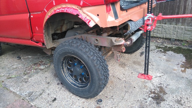

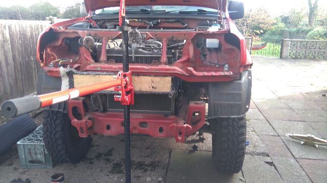

Replied by jackonlyjack on topic Body lift advice
I used hi-lift jack made easy work of it
lifted front to rear so no risk of the body sliding sideways
Jack
Jack

Jack, good shout, I'd looked at getting the standard Jack in the front easy enough but looking at your pic I realise the rear is not so simple. So this could be my excuse for buying a farm jack
Unfortunately we have no properly flat areas, and it's already up on ramps at the front and rear off side is sitting on an old van wheel to get me a bit more clearance to get to the tbox
I'm sure I've got plenty of various sizes blocks and wood off cuts from diy jobs, so can level the 4 wheels and it should be fine
