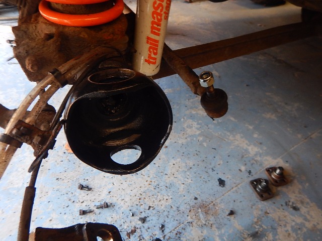

24 May 2017 15:22 - 24 May 2017 16:26 #181502 by X8GGY
Replied by X8GGY on topic Regearing my VVT Daily Driver
Pig of a job today! :(
All the bolts were mega-rusty, seized, some rounded...
... but, eventually. got the front diff out and the new (old) one in... and the two VVT diffs left by carrier to go back to James J999PRE as exchanges for the pre-VVT ones now fitted...
Cleaned everything up -
Just need to rub my balls with some emery paper! ;)
And then rebuild everything on Sunday... I was just going to put everything back how it was, but it was such a pig of a job, I've ordered new kingpin bearings and axle oil seals, to go with the ball seals I had in stock, some thin shims on the kingpins, some new grease in the CVs / knuckles, and new bolts everywhere... so at least I know it's good for another 20,000 miles or so... especially as this one won't be venturing offroad...?
My two handy tools for the job -
On the left half of a pair of plumbers over-centre pliers which are perfect for levering out oil seals, and on the right my kingpin bearing removal tool... it's a suitably sized socket on a small extension bar, the perfect size for tapping out the bearings from the axle's knuckle B)
