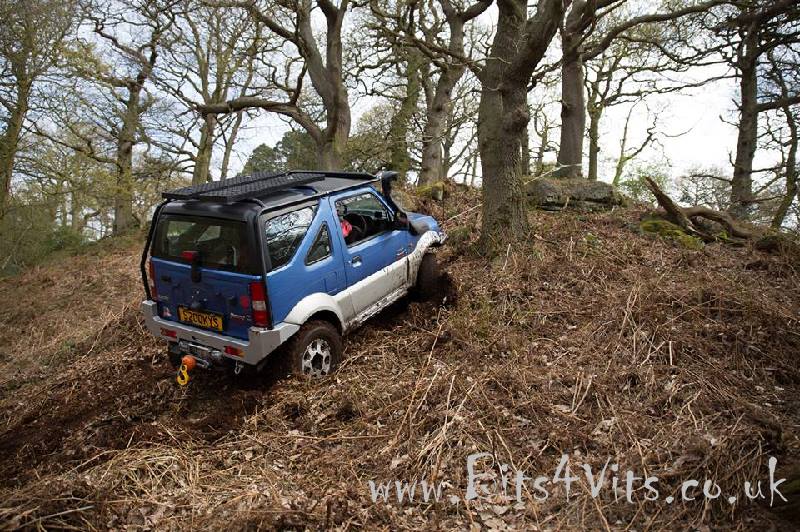

I've got a Warrior Samurai EWX8000i "fast" winch on the front with synthetic rope -
And a T-Max 9500 on the rear -
Both reasonable winches, i.e. in terms of value for money and reliability...
I've had the T-Max for three years and it's been on two vehicles, firstly on my old Vitara -
And then when I 'upgraded'
to a Jimny it went on the back and the Warrior winch on the front.
The T-Max winch is really good, I got some proper Dyneema rope for it and it's never really let me down that one, it's been through many a deep ford and continues to work fine, there was a problem with the original solenoid box, but that was sorted by the reseller (JimnyBits, excellent service as always), and then later I upgraded it again when I relocated it into the back of the Jimny -
And it's been in the Jimny for a couple of years now...
The Warrior, hmmm, it's alright... as TomDK says, the rope supplied isn't that great, I managed to snap it a few months ago - after a couple of years service mind - and albeit dragging a Discovery sideways at the time, so I've fitted it with a better rope now...
And... the only thing I can moan about is that it doesn't "brake" that well...
Dangling the weight of the Jimny on it when close to a punch up the side of the valley for instance, when you back off the winding in, it spools out a bit, rather than the T-Max which when you let go of winding in just brakes and stays there...
Both have been reasonalbly cheap and reliable though, but I would plum for the T-Max over the Warrior and get some decent rope for it...
I've no experience of the Goodwinches so can't comment on them... TomDK likes them though
Hope all that helps anyways...
