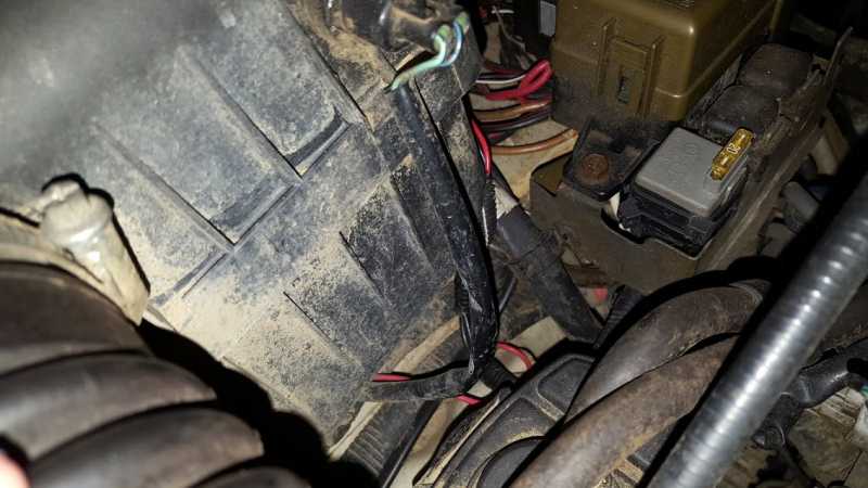

IAT Sensor - where does it go ?
- Posts: 3047
- Thank you received: 686
07 Oct 2016 19:04 #173235
Replied by jackonlyjack on topic IAT Sensor - where does it go ?
can't help with where it terminates without wiring diagram sorry
Jack
Jack
07 Oct 2016 19:20 #173238
by Keithy
Replied by Keithy on topic IAT Sensor - where does it go ?
On mine it has/had 2 wires and the light green with black trace went to pin 15 on the ecu E48 on the
Jimny wiring diagram
page 75, I'll have a look in the morning but mine is a 2001 car.
- samui
07 Oct 2016 20:12 #173247
by samui
Replied by samui on topic IAT Sensor - where does it go ?
just follow the loom how u need a diagram.
07 Oct 2016 22:21 #173253
by Keithy
In your original post you asked where it went....it goes to pin 15 on my original ECU....not entirely sure I understand your post....
Your IAT sensor is the one on the left....mine is the one to it's right....I don't use the original Suzuki one on my Jimny....samui wrote: just follow the loom how u need a diagram.
- samui
08 Oct 2016 05:55 #173265
by samui
ok guys im real bad at following diagrams... i have the iat in the airbox with no connection to it... i also have the loom with the same connector on both sides one of goes to the IAT ... question is where does the other side plug into ?? Thanks and apologies for dragging this on,.
12 Oct 2016 11:04 #173426
by Jezz
It's been fettled just a tad.
Replied by Jezz on topic IAT Sensor - where does it go ?
On my 05 soft top, It plugs into the sensor and the wires join the main engine loom directly below the airbox.
