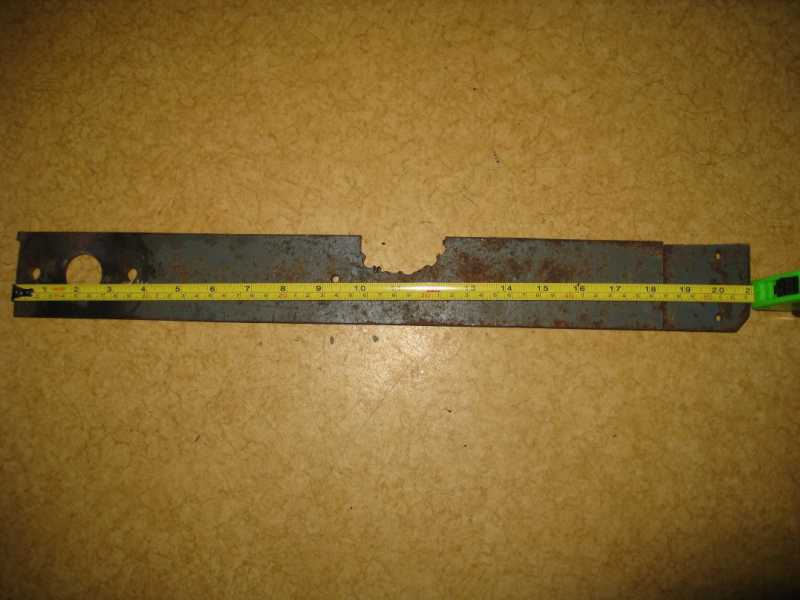

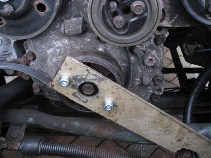

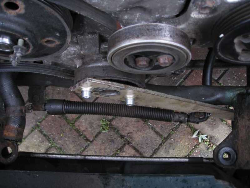

I used a piece of 1/4 plate 2 1/2" wide and 21" long, but I reckon 18 " is more than enough.
I had to chop a nibble out of it to miss the power steering pipe bracket, it wedged nicely against the chassis, and worked just the same on the other side so I could gently tweak the new bolt to around 110ft lb (my wrench only goes to 100, so I wound it past by what I reckon was 10lb on the scale)
The Suzuki tool is just the pulley plate with a piece of thick wall tube welded on, but I used what I had as a one off.
Notice the plate is just big enough to clamp solid to the inner pulley, as it is friction here that holds it, not the two M8s, they will bend like bananas if the plate is loose.

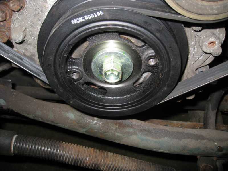

The new one looks like this (ooh shiny :lol: )
The 2 threaded holes are on 74mm centres and fit ISO M8x1.25 bolts to attach a plate to hold the crank still when you undo the nut with a wrench.

Undo the pulley bolt 17mm AF, either with an impact gun if you are lucky, or do as I did above and slice the big washer off (I made 4 cuts 2 more than the pictures) and then it will undo easily.
Pull the pulley off (use a puller it it won't slide off)
Smear a little grease around the outside of the new pulley boss where it is to go into the oilseal, and push the new pulley on.
Use the new bolt (you paid for it, so use it ;) ) to secure the pulley (150 NM) You may need to find something to stop the engine turning if it wont hold enough in gear.

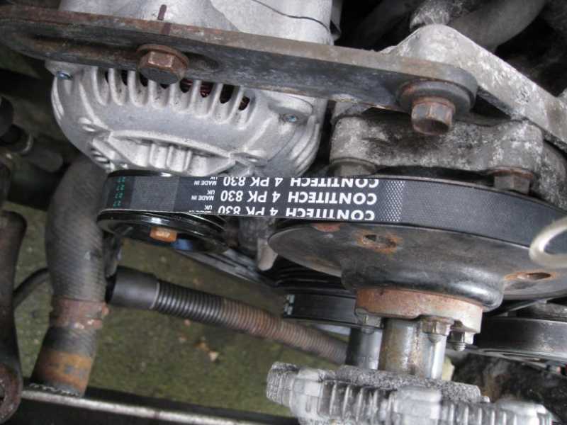

Slacken the alternator lower pivot bolt, and the adjuster bolts and push it right toward the engine, and put on the new belt 4pk830 or 4pk835/4pk836. The 4pk830 will go on, but you will have to turn the crank and work it on.
Adjust it now and tighten the adjuster bolts, (finally tighten the fan extension nuts if you disturbed it)
