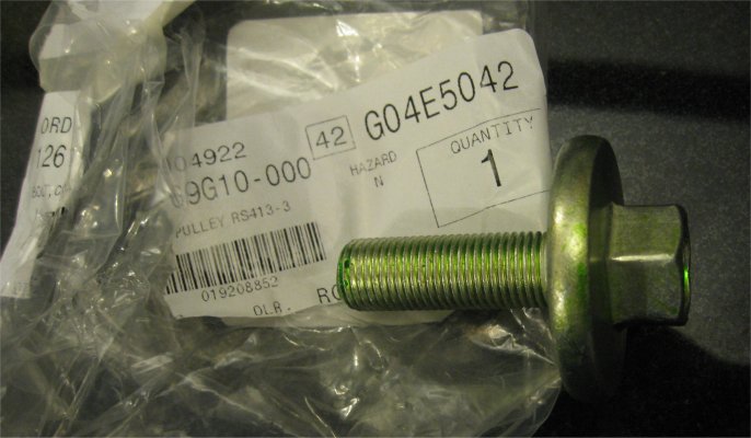

This is the new bolt

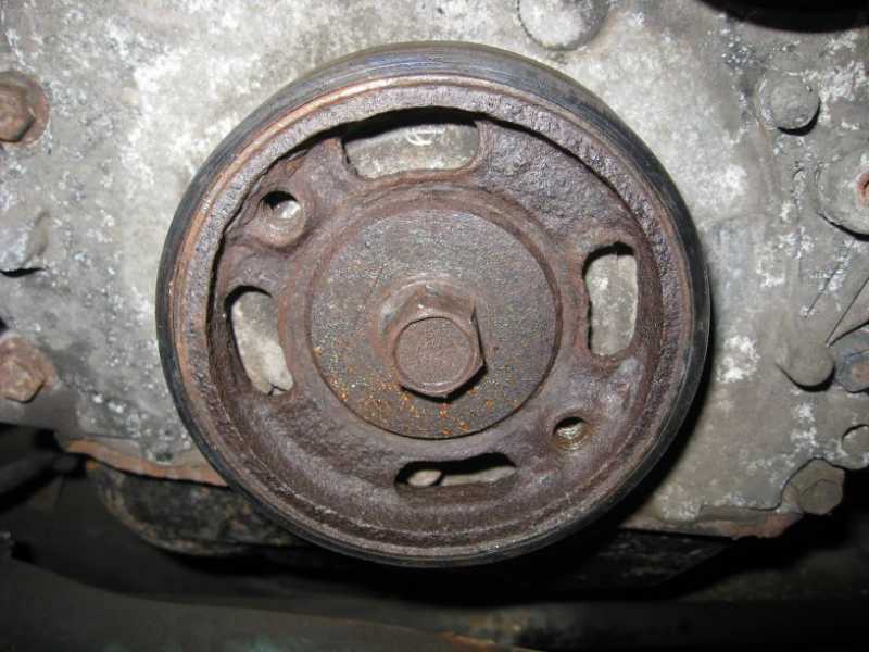

This is my car

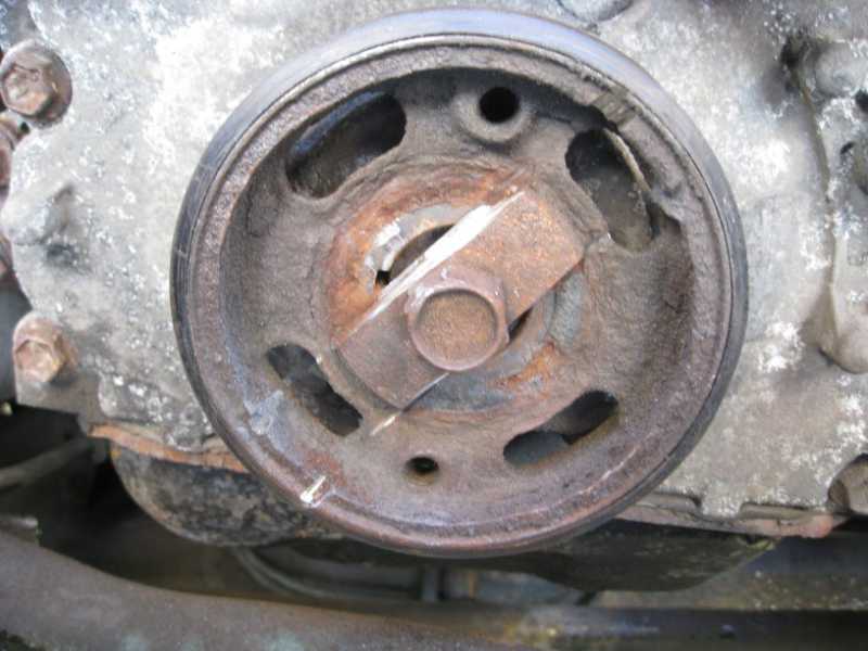

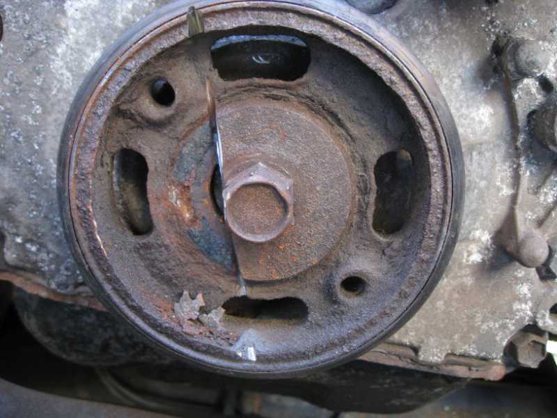

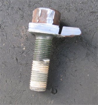

This is what I did
I made 2 more cuts at 90 degrees above and below the bolt head.
And then it came out with my fingers, and the pulley just slipped off.

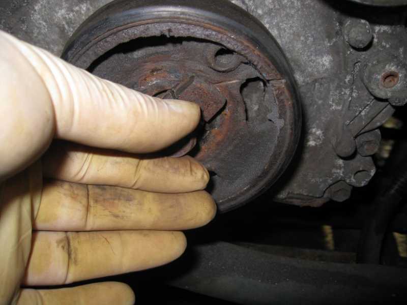

This is what I did
Unbelievable :pinch:

You did well
. And what a stupid design. That is going to weld itself to the pulley with rust.
