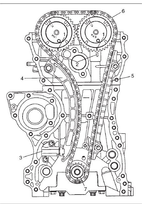

Are there timing marks on the camshafts ?
10 Oct 2015 21:24 #153378
by facade
Replied by facade on topic Jimmy 2003 Dohc timing marks and crank pulley nut
There are scribe lines on the can sprockets (1) that match notches on the head (2)
Are you doing this without a manual?
They are easy enough to find as a PDF
