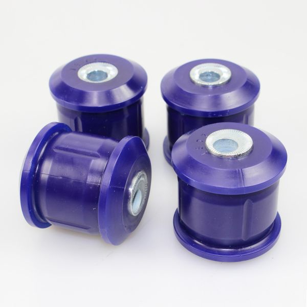

I've been thinking about the Jimny ... oh oh ... this post goes on a bit :whistle:
I have a clunk that occurs when either pulling away, or on slow full lock, at first thought maybe it was the rear 3 section boarded out floor, so took it out and made a new single piece one.
still clunks
so I'm thinking it maybe the radius arm bushes and/or worn bolt holes.
also the Jimny death wobble has returned albeit a Jimny shimny at the moment, but as I've recently changed the knigpins and all the track rod ends, I'm thinking maybe worn front (leading) radius arm bushes/bolt holes could be the cause.
If I proceed to change bushes, would it be OK to use castor corrected ones with my current 1.5 inch spacer and shock extension lift, as I will eventually fit a 2 inch AVO lift.
Also possibly a dumb question but do you need to use castor corrected bushes on the rear arms or just the front ?
and which type to get ? they all look pretty expensive :blink:
flo-flex Two piece castor corrected Bushes
Super Pro Polyurethane Caster Correction Bushes
original type castor correction bushes (require press to fit)
what do you think :blink:
going to order some new bolts and investigate the holes/bushes.

06 Sep 2015 15:20 #151439
Replied by Daniel30 on topic Radius arm bushes
I can't believe it would hurt to put corrected bushes on alot of people put them on a 2 inch lift so your only talking half-inch less on yours at the moment Halford
as for the bushes I've got some of Daves waiting to go on as I'm new to this too I can't comment on others until I have experienced them sorry :blush:
- OllieNZ
06 Sep 2015 16:33 #151440
by OllieNZ
Replied by OllieNZ on topic Re:Radius arm bushes
The two part bushes are easy to fit and still soft I can't speak for any of the others. You could experiment with the poly bushes easily as the centres are turnable until you clamp them up and maybe run a touch less correction if you feel it's too much, whereas the press in type will be a bit more one shot.
