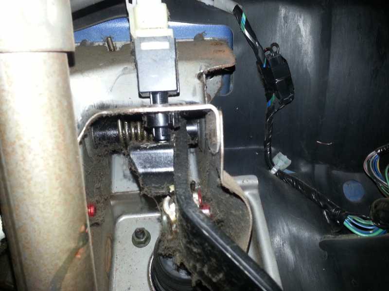

Its possible that the pedal switch is incorrectly adjusted look up the back of the dash and follow the brake pedal,you should see a switch to the top at a guess it will need adjusting so that when the pedal is in its resting position the switch is fully depressed.something like that anyway hard to explain if you dont know what your looking for.will see if i can get a pic of mine.

Take a look at the switch as gaz suggests, it is likely broken off or unclipped.
If you disconnect the wiring plug from the switch, the brake lights should go out anyway.
