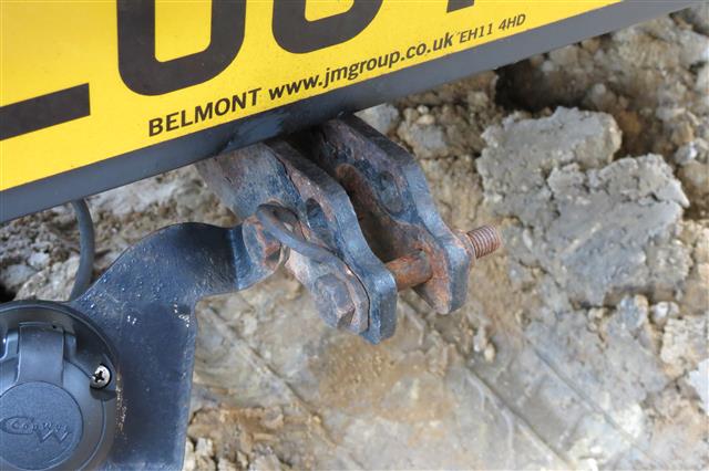

I have the same problem as well but I hadn't been able to identify the towbar, mine looks like this:
