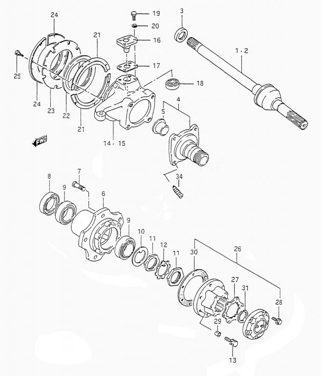

steering knuckle oil seal, bearing gasket. was created by benkri1992

Replied by safari on topic steering knuckle oil seal, bearing gasket.
hi num 3 is the oilseal and if i am not wrong if it is gone chq also king pins for exasive play they do not wear alone

Strange schematic, as it appears to show a manual free wheel hub, not the vacuum operated hub you would expect on a Jimny...?

Daves correct, that looks like an SJ diagram as it also has the felt pads in it

hmm, okey. but my problem is that its leaking oil in to the knuckle house.
and i am change the seal. does anyone have the right drawing for the jimny then ?
