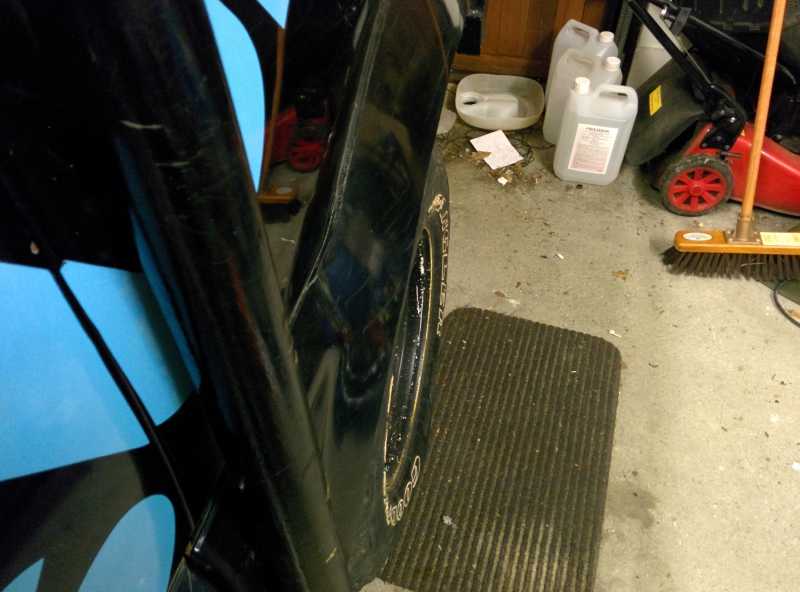

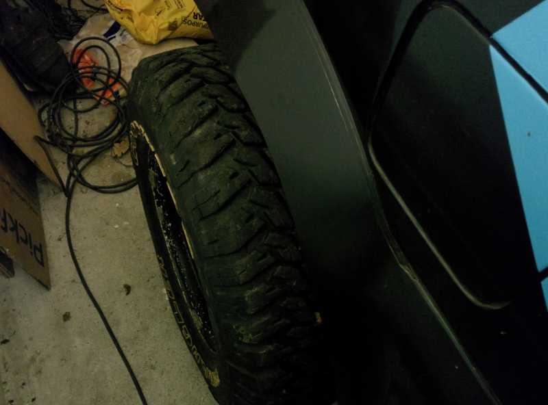

16 Dec 2014 21:28 - 16 Dec 2014 21:29 #132532 by mlines
Left hand side (UK Passenger side)
Right hand side (Uk Driver)

  • supergaz
16 Dec 2014 21:31 #132535 by supergaz
Replied by supergaz on topic Re:Rear axle 2 inches to the right!
You have the ora mounts/ brackets so the panhard mount is higher, so you need to shorten your panhard rod. Bet you never had your axles fitted with those mounts on?
