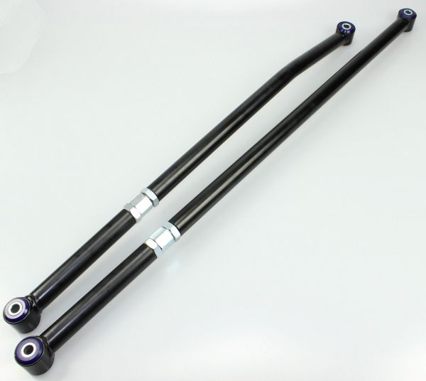

Is there anymore panhards available with bush ends not the rose joint ?
Cheers vinnie
Replied by Vinnie on topic Steering wheel not straight after lift ?
dirtydogz wrote: Yes you will still need to extend the panhard rods to get the axles back in line.
Or just buy adjustable ones. www.jimnybits.co.uk/shop/jimny/suspensio...arm-set/prod_23.html
www.kapsuzuki4x4.co.uk/suzuki/jimny.php
Cheers vinnie
