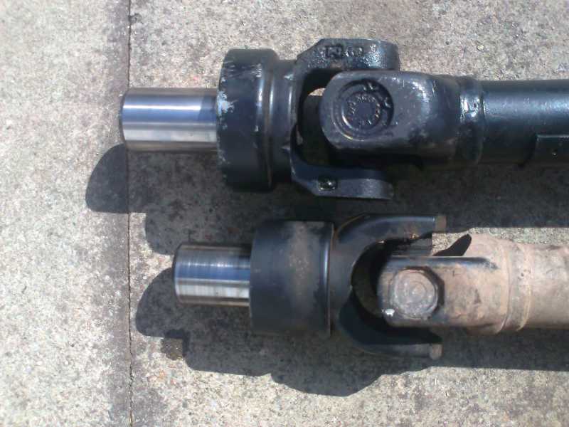

I had a crawl under the truck with a torch and had a proper poke around - turns out its the UJ on the centre prop thats failing
already have a replacement on order from CAM for £22 inc delivery - I did ring the main stealer for a price, but switched off when he said it was more than £280 plus the VAT :ohmy: :sick:
Its definatelt getting worse though, the drive to and from Dorset last weekend was just about bareable, the drive to Chesterfield on Weds the noise was deafening, but now its a case of being gentle until the new prop arrives. Interestingly, the centre props are different between jimnys, as CAM and me found out. CAM posted one out and i tried to fit it, only to discover it was slightly longer and the spline end a tad different and so won't fit - see pic, but correct one being shipped from CAM already - 5 stars to CAM for being super great.

I think thay are different between single cam and twin cam engines or manual and auto cant remember which
