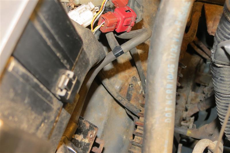

My VSVs and switch were just hanging in free air, another dodgy job by a previous owner:

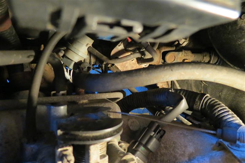

I didn't have time to sort all that out so I pulled out the switch and VSV module. I blanked off the manifold take-off and then used the T=piece from the
pipes that I removed to connect together the remaining pipework to keep the dirt out:

18 Apr 2015 20:14 #142739
Must compliment you on the nice clear pics James.
I am one of those who leaves some things free hanging, especially if it is awkward to reach or if I am returning to it frequently...........and cos I am too idle to refit stuff. :blush:
So it worked fine in the end??

19 Apr 2015 19:10 #142776
by Rhinoman
Replied by Rhinoman on topic Stopping the flashing 4WD light with pictures
I just got back from Tong, 4wd worked perfectly and no flashing light.
