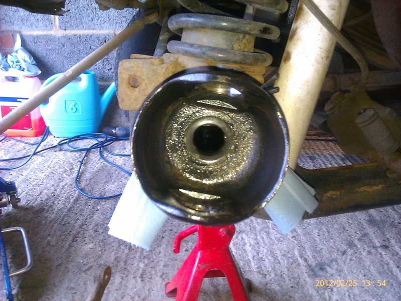

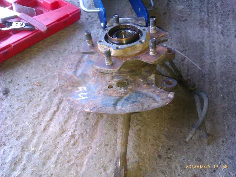

If you are really short on time:
Remove wheel Place flat on floor flange upwards
Remove small bolts holding large oil seal around hub.
Remove calliper and hang up safe.
Split track rod & tie rod balljoints.
Disconnect rubber vacuum pipes
Remove 4 top & 4 bottom kingpin bolts
Remove kingpins.
Snatch off complete hub, with brake disk, driveshaft etc
Place Hub in wheel, so it stands up.
(may need services of A.N.Other so it doesn't fall.)
Get A.N.Other to remove any gunge &crud from Driveshaft & hub cavity with paper towels whilst you knock out bearing races.
Fit new outer races.
Change oilseal.
Grease cavity
Feed driveshaft in replace hub & bearings (yes it will go straight back, you may need to twiddle hub to engage.
Replace kingpins
Replace oilseal.
Replace calliper and steering joints.
Replace pipes
Replace wheel.

Thanks for the pics. It's a lot easier to figure
