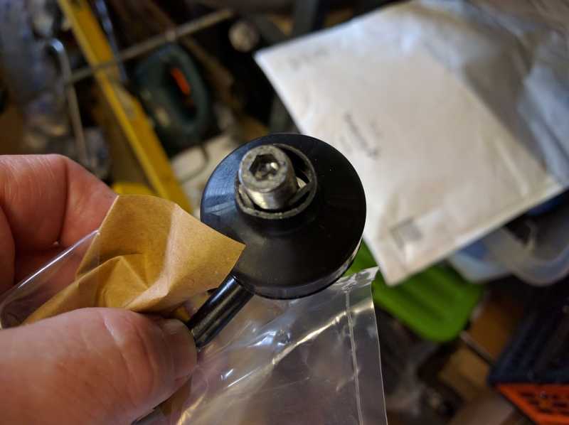

A lot of drop links have an allen key socket in the end of them to allow you to lock them and undo the nut. The hole is often full of mud and therefore hidden but it can be cleaned out with a screwdriver and makes undoing them easy.
