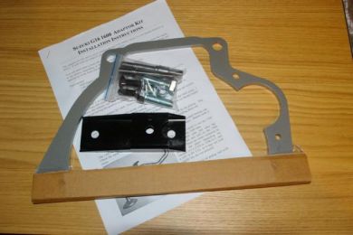

Either re-drill the block or buy an adapter plate. Same as the SJ conversion write up on here.
Note: If buying an adapter plate buy one that has the full ring around the bottom of the bellhousing. Every adapter plate I have seen was for an SJ and didn't accommodate for revised clutch cable on the Jimny. So we simply cut that bit of the plate out so that the clutch cable entry mount fitted snugly. You will also need to drill the top 2 gearbox bolt holes out to 12mm from 10mm so you'll need the bellhousing bolts from the Baleno as well if you can pinch them.
Also the countersunk bolts to mount the plate... They'll probably be 1.25mm pitch thread. The Jimny box is 1mm pitch. Most just graunch the bolts in. I re-threaded them to 1mm.
