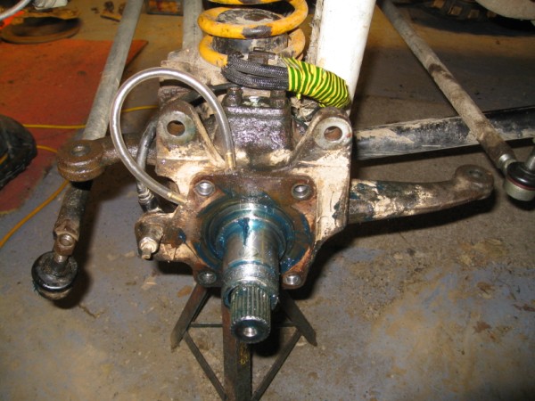

Hi All
I`ve just fitted a set of manual hubs,where would be the best place to block the pipe
so as to stop the 4x4 light flashing please
Cheers
Pete

see my post on this a while back, worked a treat
www.bigjimny.com/index.php?option=com_ku...7&id=14562&Itemid=75
let me know if the link doesn't work and i'll email pics etc.

Hi
Thank you for your input, now sorted
Joined both inlets on each hub together then joined the two form the chassis
all pipes removed off the front axle and castor correction arm
Cheers
Pete
