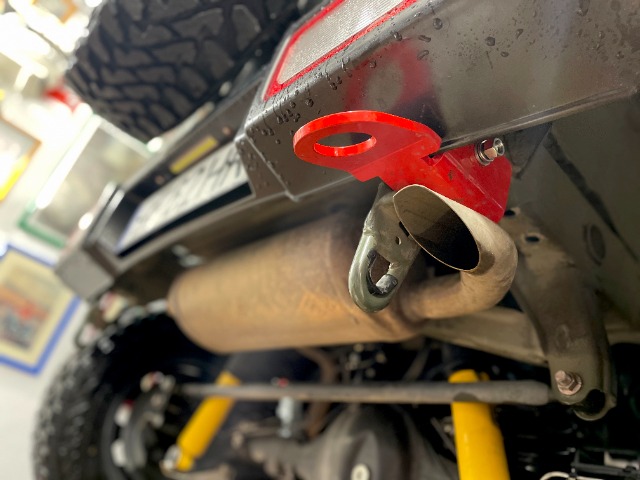

Just my opinion - I wouldn't use soft shackles with any of the recovery points pictured in this thread, the edges are too sharp. I'd prefer to see a smooth radius similar to the factory "tie down" points.
08 Nov 2024 09:56 #258224
by 300bhpton
Replied by 300bhpton on topic Towing Straps/Extenders advice sort
Is that with a standard rear bumper? Who makes that recovery point? Thanks.Enough for me
08 Nov 2024 09:59 #258225
by 300bhpton
On mine the edges are bevelled nicely, you can just see it in the pictures, but it is hard to see in a photo. In real life they are clearly designed for soft shackle use. Which has been tested in my caseJust my opinion - I wouldn't use soft shackles with any of the recovery points pictured in this thread, the edges are too sharp. I'd prefer to see a smooth radius similar to the factory "tie down" points.
