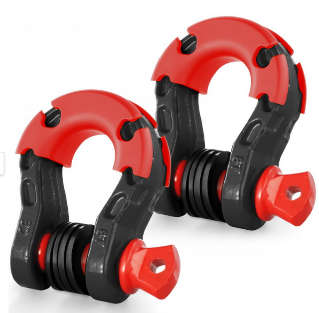

I found a shackle with rubber inserts, these might sit in an upright postion and not mark the bottom of my bumper.
The rubber washers round the shaft might clamp round the recovery points and hold them in a horizontal position. The I could use a soft shackle or just a short fabric recovery strop.
Robin

Those look very over designed to me, like someone has tried to add everything they can think of to the point I wonder if they have designed out the functionality. I get that you want them to be quiet so why not just get some regular ones and some large heat shrink and then you can colour code them high visibility yellow.
