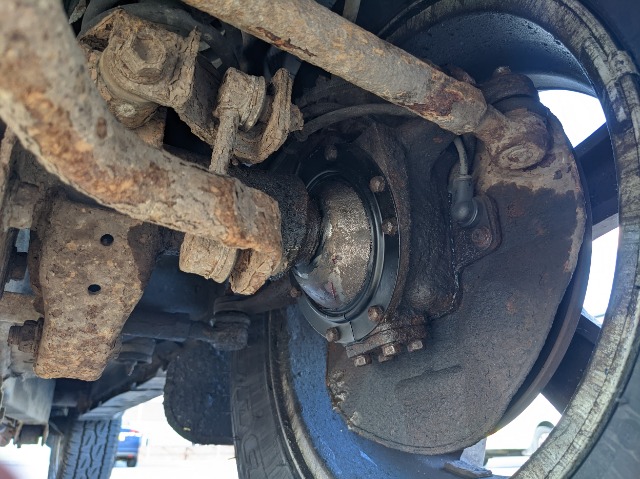

I have exactly the same problem, heard a slight rattle from the front end, looked underneath and grease all over the swivel joint, even got splattering on inside tyre wall. Same on both sides. Can someone confirm that I need to order "kingpin bearings and swivel seal" £48 a side from bigjimny store. Thanks

31 Aug 2022 08:34 #244804
Replied by Lambert on topic Garage near Aylesbury (Buckinghamshire) for front axle seals/bearings
That's correct.

got my bearings and seals from bigjimny shop and my local garage changed them both. They too were concerned about the balls being pitted and potentially ripping the seals. Martin says this is all quite normal, so should i be concerned ?
