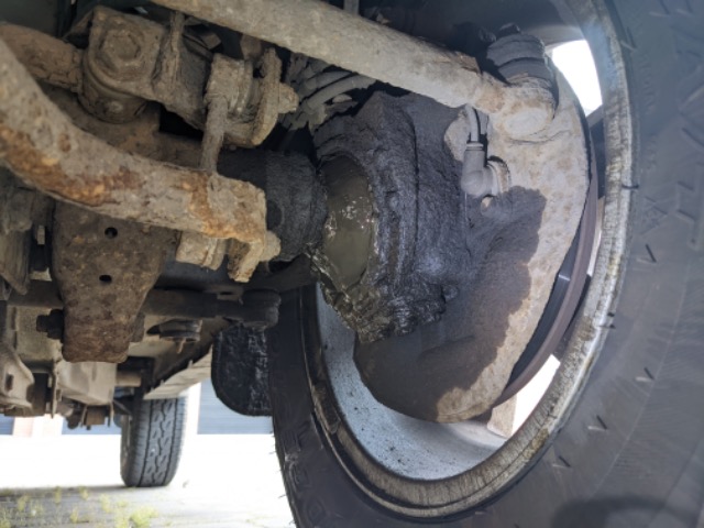

I’ve just driven 450+ miles south from Dundee to Aylesbury, moving house for a new job. A few days before the move, I discovered what I now understand is a common issue - a lovely mix of diff oil & CV grease leaking from the passenger side front wheel swivel. I couldn’t get it seen to in time before the move, but the car was still driving fine & I figured the only danger would be if the front diff ram completely dry. I had it topped up at a local garage (took 300ml) & asked them not to over-tighten the fill plug, so I could remove it & check the level myself halfway down & once I arrived. As far as I can tell, it’s still essentially full & there’s only a tiny drip on the driveway this morning.

Photo taken before the move.
