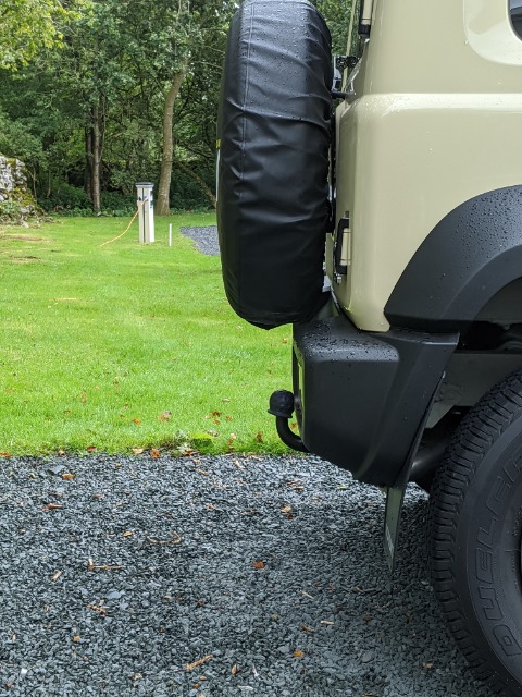

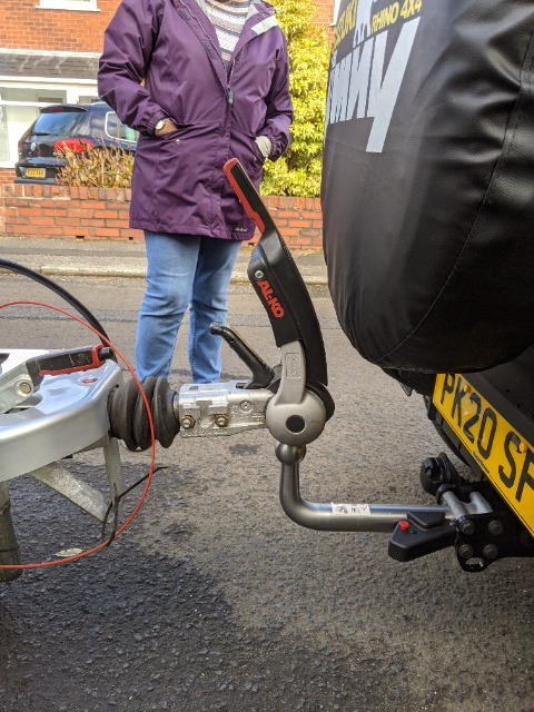

 I tow a small caravan and had some pain getting a tow bar fitted. The local tow bar specialist used the official harness to keep the warranty valid, however they used an after market detachable swan neck made by Brink. I wanted detachable as if you get a fixed one  and go off roading they become potato digger and they also smash your shins putting things in the back of the car.
Anyhows the Brink towbar very quickly became useless when I offered my caravan hitch to the ball. I could not get the height to engage my Alko anti sway device as the towbar was to short and under the spare tyre. The towbar dealer changed out the towbar for the official Suzuki one which clears the spare tyre and is perfect. The swan neck fits in the SZ5 rear box when not in use.
