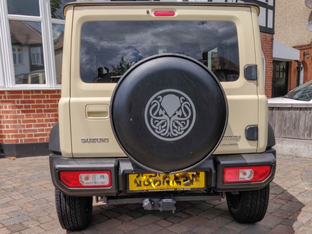

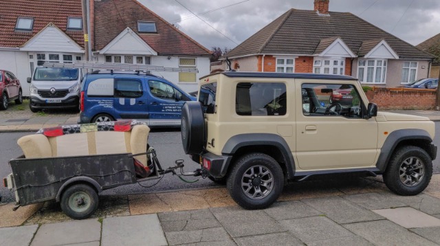

I have/had the OEM Suzuki towbar fitted. Seemed to work fine the two times I used it (once to tow a trailer, once to drag a wrecked car out of the road). Currently sat in the garage as it's a lot of weight to cart around and I've not needed to tow anything for a year or more. Left all the electrics in place, with the socket bagged up and cable tied inside the rear bumper. Fitted rear recovery points instead (they can't co-exist as they use the same mounting points), which are a lot lighter and less likely to act as a plow when offroad.

I've got the genuine towbar with the detachable swan neck too. The detachable bit lives in the Suzuki supplied bag in the house when not in use (I don't fancy it flying around inside the car in an accident)
Suzuki fitted it, and they have to throw the fuse box cover in the glove box as the live feed to the 13pin socket is on one of those jumper fuses, which didn't impress me, you think they'd have a wiring harness connector ready for it.
