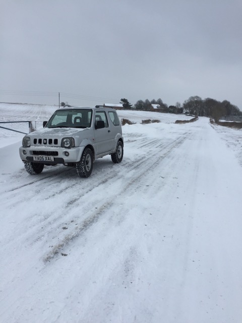

I fitted 215 75 x 15 BFG KO2 AT's on my car when completely standard and the impact on gearing is minimal, it actually made the road speed and speedometer line up accurately. It does hit acceleration but again not too much.
My car had very tired (low) suspension and there was no rubbing at all. I then fitted 32mm spacers (which fill the arches perfectly, all tread covered) and there was a tiny catch at full lock.
I think these pictures are with the tyres and nothing else...
215's do look better but they do hit you with a few negatives... acceleration & fuel... but was happy with them.

Thanks Sniper , good info , the 215's look fine on your ride.
