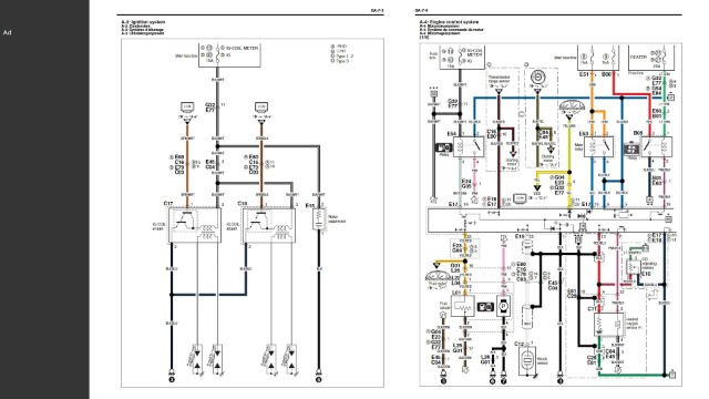

Hi Roger, if I'm reading it correctly (and don't hesitate to correct me if I'm wrong please!) it looks like the ECU is fed from the ignition coil 'Meter' which is Fuse 18.See the diags...
