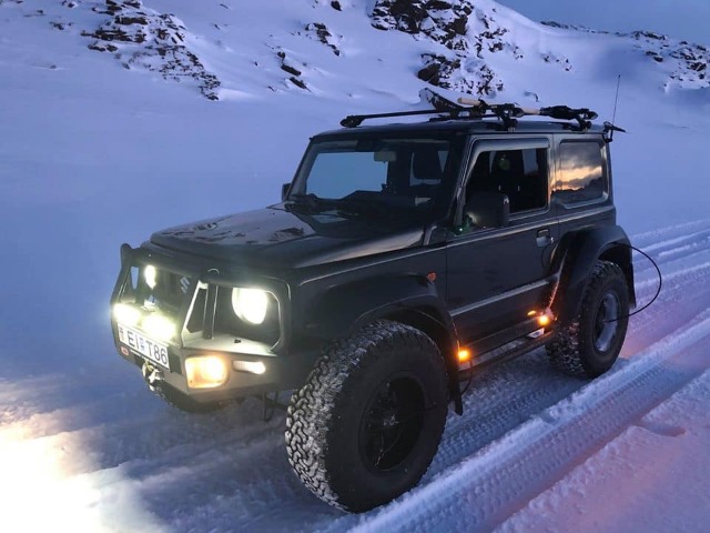

Give or take a small ratio change and probably some more electronic sensors fitted, the Gen 4 transfer box is the same as the early mechanical Gen3 transfer box (they abandoned the push button selection).
That pictured Gen4 must have some changes otherwise it would be all but impossible to drive without destroying the clutch. Again, give or take minor changes, I would guess it is straight forward to put on an SJ box with reduced gearing or put in the reduction gears for a standard Jimny box (although with those tyres I would guess the chain would slip pretty quickly). Also the Gen4 diff appears to be the bastard son of a standard Jimny diff and a Grand Vitara diff so again I am sure the ratios can be changed in that as well.

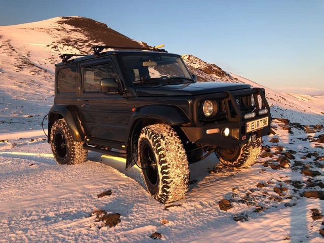

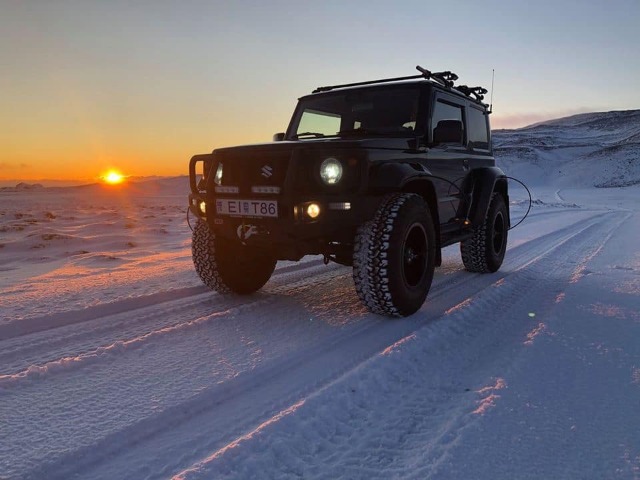

Some more pics of it from their facebook...
Looks awesome and there seems to be plenty of room for the huge tyres. I suspect probably some toyota axles are hiding under there with low ratio diffs in, or at least thats how I would approach gearing it down. It seems wider, hence the axle swap suspicion
