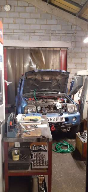

28 Nov 2019 10:35 #216045
by Mole
Replied by Mole on topic Heater and fan
28 Nov 2019 14:22 #216047
