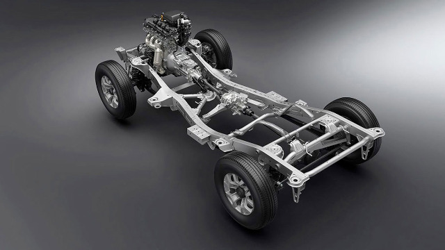

Based on similarities in the gearbox ratios and towing limits that are starting to emerge, does the new Jimny utilise the existing VVT Jimny Chassis and running gear?
New Suziki motorcycles tend to raid the existing parts bin, its a way of keeping development costs down.

03 Oct 2018 07:45 #196459
by AlexK
Certainly from the language Suzuki have been using, it seems safe to say the new model builds on the previous one, rather than being 'all-new.'
So far, we know the chassis incorporates a new x-member plus two new cross-members for increased torsional rigidity, the eight body mounts have been redesigned, the front stabiliser bar is thicker, the front axle housing is made from 'more robust' high tensile steel, and the rear axle is of a larger diameter with 30% higher 'flexural strength.'

03 Oct 2018 08:20 #196460
by facade
Replied by facade on topic Got questions about the new Jimny?
Seems like they are fixing a chassis problem we never had, what are those rust-trap boxes on the side rails for?

by Jezz
It's been fettled just a tad.
Replied by Jezz on topic Got questions about the new Jimny?
I would imagine but could well be wrong, That all the chassis tweeks are for it to try and get a better n-cap safety rating.
03 Oct 2018 10:08 #196465
Norway 2005 Jimny M16A VVT, 235 BFG MT, 2" Trailmaster, ARB rear lck, 17%/87% high/low gears.
Replied by yakuza on topic Got questions about the new Jimny?
The similarity in the transfer case gearing, and the design of the lever makes me think the electric VVT actuator is just replaced by the manual lever that do work in the same shift pattern.
It might even be possible to change the old actuator to the new lever on our old VVT's.
