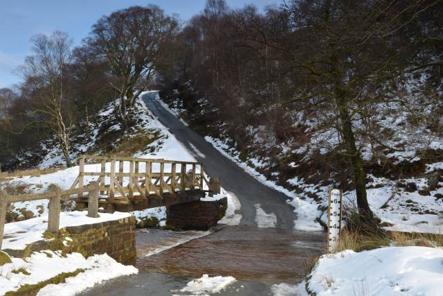

Replied by grumyoldjoe on topic 4wd on snow covered road
Here is one of the fords I mentioned
big icy gradient as you come out, but if no ice you would have to wait until the top before changing back to 2wd, would this distance cause any issue ?
Wine improves with age.
Last edit: 06 Mar 2018 18:16 by grumyoldjoe.
06 Mar 2018 19:09 #190031
by Busta
Replied by Busta on topic 4wd on snow covered road
Not in a relatively straight line over such a short distance, no. Why would you have to wait until the top before changing to 2wd though? You can change whilst on the move at up to 60mph.
You're not going to break things the second you use 4wd on a grippy surface. The transmission isn't that fragile and there are warning signs- heavy steering and tyres scrubbing. But at the same time it's important to be aware that it's not okay to use for extended periods of time on high grip surfaces.
