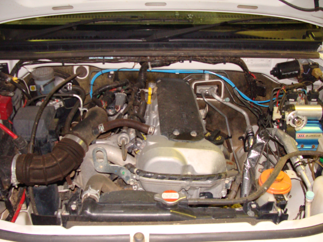

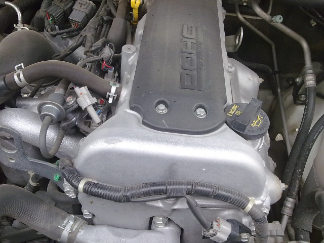

to be sure check the front end of the head.If it's a vvt it will have a bump on the end. non vvt is smooth

Yes it has a chain and yours is a VVT.
