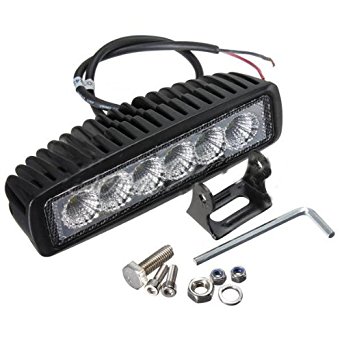

Daniel - just standard bulbs I assume (not looked yet), so I might upgrade them as well. I happen to have two of these already and they will look good in the bumper recess :)

13 Oct 2016 15:58 #173488 by Daniel30
yeah n ice little addition nick let me know how you get on with them after my bumper chop i could fit some of them B) to my existing fog switch
