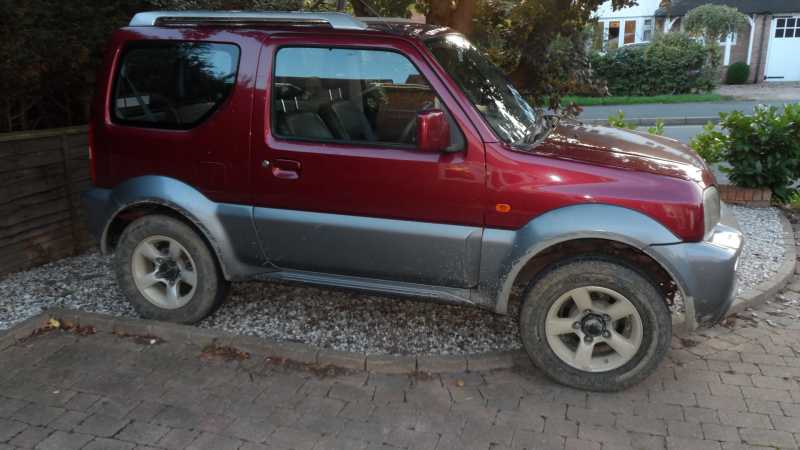

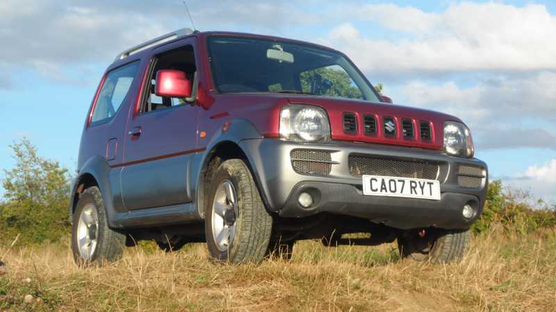

Dan - those 205/75/15 Grabbers look like they come out of the arches on the 30mm offsets, but you mention they fit okay - is it just the photo making them look protruding, or are they MOT-failure risks?

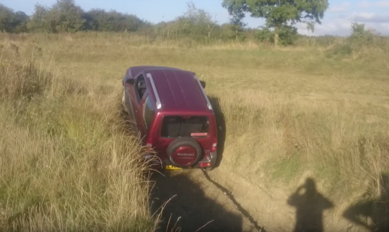

I will take a load of pictures before I start and as it progresses, but here are some of the "before" that I have
I fitted an Android head unit with a USB dash cam for recording everything / everyone I see ahead of me off-road, but that does leave me with very few pictures of the Jimny itself off-road

The side wall sits outside a bit but the tread sits just under the edge I've had an mot as the Jimny is at the moment and flew through
