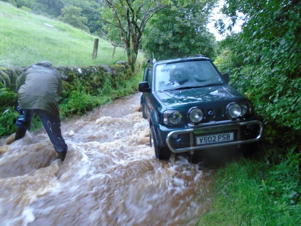

I recently bought a 99 jimny, all looks good drove it 60+miles home and it seemed fine. a few weeks later we had serious floods down our way and our road got washed away, i though no problem for the Jimny, but the 4wd light started flashing and didn't work. It worked when i took it for a test drive before buying it so it must have got a knock when i was stuck as there were some nasty boulders in the road - i only realised the extent when the floods dried up a bit.
So as i was stuck in the road in the middle of a flood with no 4wd i had to get a neighbour to tow me out, and in the middle of it all the back shock must have taken a knock because now it is hanging off - it came away from the axle. I took it to a garage the other day and he said it'd take approx 4 hrs to make something up and get it fixed properly in time for the MOT in a couple of months. He said also that the other shock doens't look too good and could come away soon too. he's going to charge me £42/hr so the bill could run away by the sounds of things - can i get some advice?

03 Sep 2015 11:37 #151226
by ivan83
Replied by ivan83 on topic New to Jimny - need help
03 Sep 2015 11:42 #151227
Replied by Daniel30 on topic New to Jimny - need help
That's better :laugh: Blimey yeah they were bad

So sorry to hear about and see the damage.
I think you are going to have to go with your mechanics advice

All the mountings on your axle look really badly rusted I'd think the radius arm ( painted Blue) mounts will be next and it won't be easy fir your garage to weld anything to. Personally I'd be looking for a second hand axle with less rust, should cost about £100.
