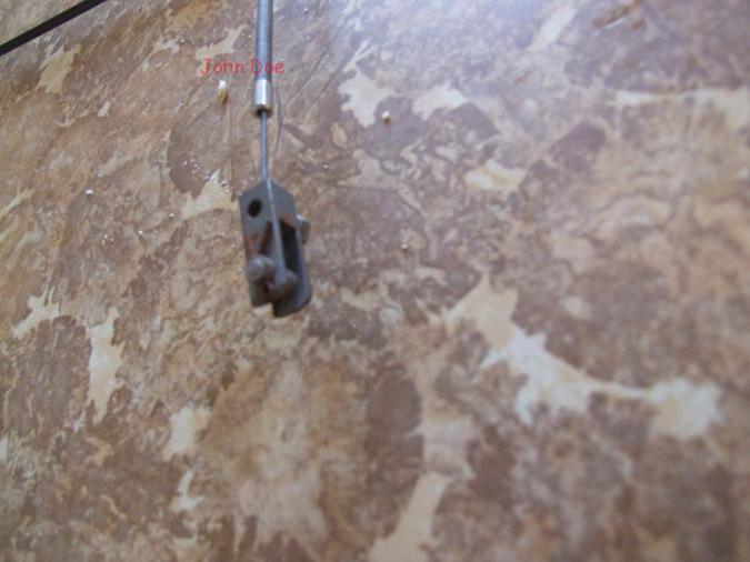

  • helijohn
11 Jun 2015 05:41 #145791 by helijohn
Replied by helijohn on topic Idle up switch or hand throttle ?
GraphicX wrote:
so do you think my best bet would be to somehow attach it to my accelerator pedal john ?
It's sort of up to you but I made up a link which slotted around the end of the throttle cable at the top of the Pinin's pedal.
I bought a choke cable off eBay (eBay item number:391035065658) and tailored the coupling to suit the choke cable end fitting. I had to shorten the cable and so I went for one with a solid inner wire rather than stranded.
